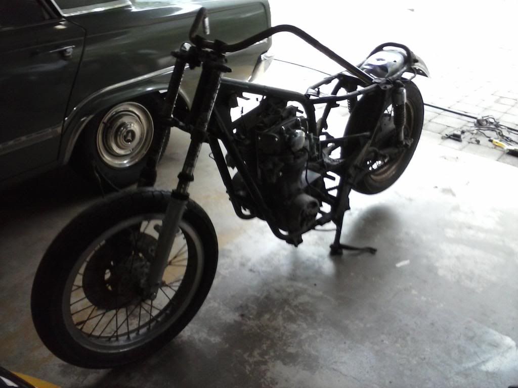

Thanks mate. Bit of a update. I got a chance to work on here yesterday.
I got her running beautifully. I did cam chain tention, valves clearances, sync/tune the carbs and set timing. Also found a large vac leak on the rubber boot on the right cylinder making it run really hot.
Now that I no the engine is good. Its time to strip her down to the frame.

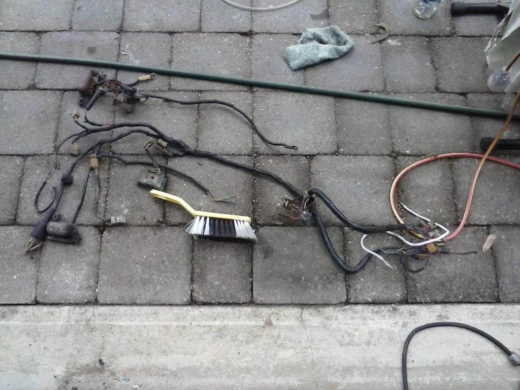

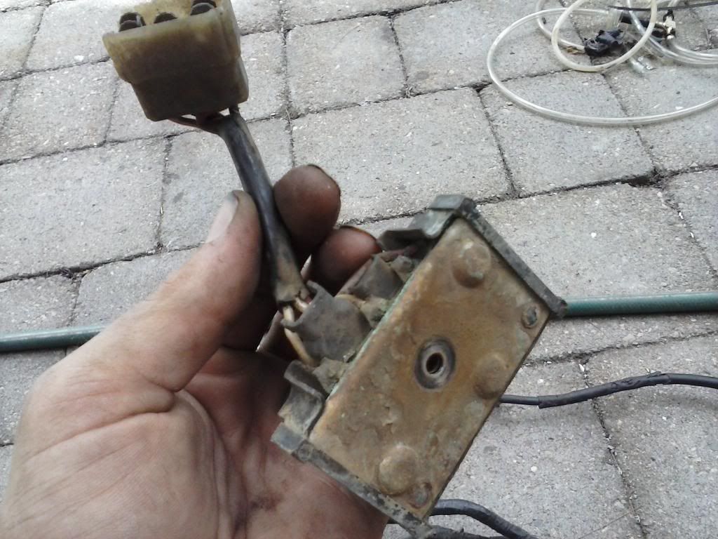

Wiring loom.

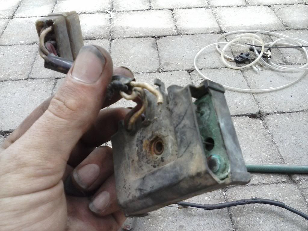

What is this? It was under the battery box.... Im guessing its the rectifier? It looks very dirty and corroded. The bike was charging so I might just clean her up. Im still unsure If i will upgrade the ignition.

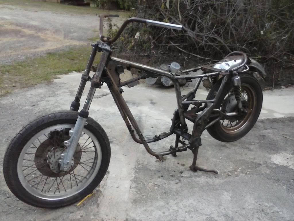

I think Im just going to spray the frame..... Whats other paint choices other than 2pak??
I was even thinking something like Raptor bed liner or similar.

Looks like the rectifier.
Any paint will do the job, Enamel, Acrylic, 2pack etc You could even get Hammertone finish, or powder coat it.!
Comes down to monies, longevity and preference. 2Pack is used mainly for finish, and is 'almost' chip resistant. It's costly, and dangerous to your health. But done right, is awesome ! Powder coating is cheap, very durable, and can be done in most towns and cities. Up to you really. :D

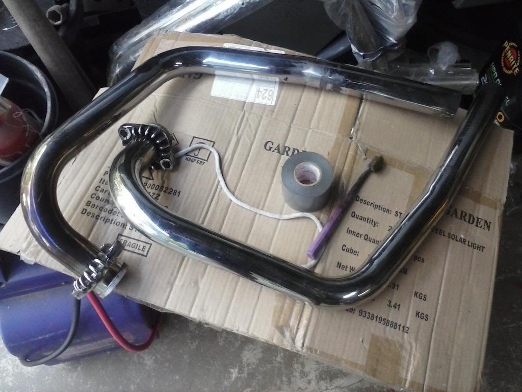

Also my SS aftermarket headers turn up on Monday. I had planed to make up my own out of pool ladder tubing but I picked these up so cheap with 2 exhaust flanges it wasn't worth my time lol.

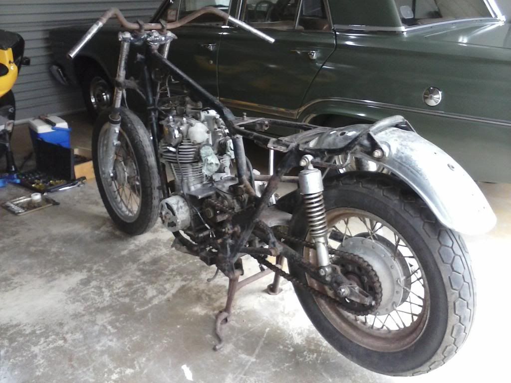

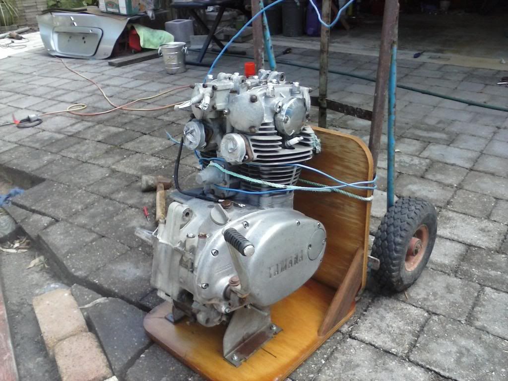

I got the engine out of the frame and made up a engine stand that I mounted the engine on for easy transport in and out of the shop. I plan to tape everything up and give the outside a quick soda blast and another wash. Should come up nice.
The old boy just couldnt help himself and started stripping off the old paint..
Next step is to remove the rear wheel, gaurd and swinging arm.

Good pickup on the SS exhaust, will set it off nicely. Will last a hell of a lot longer running unleaded fuel too. Mild steel wont last as long.
