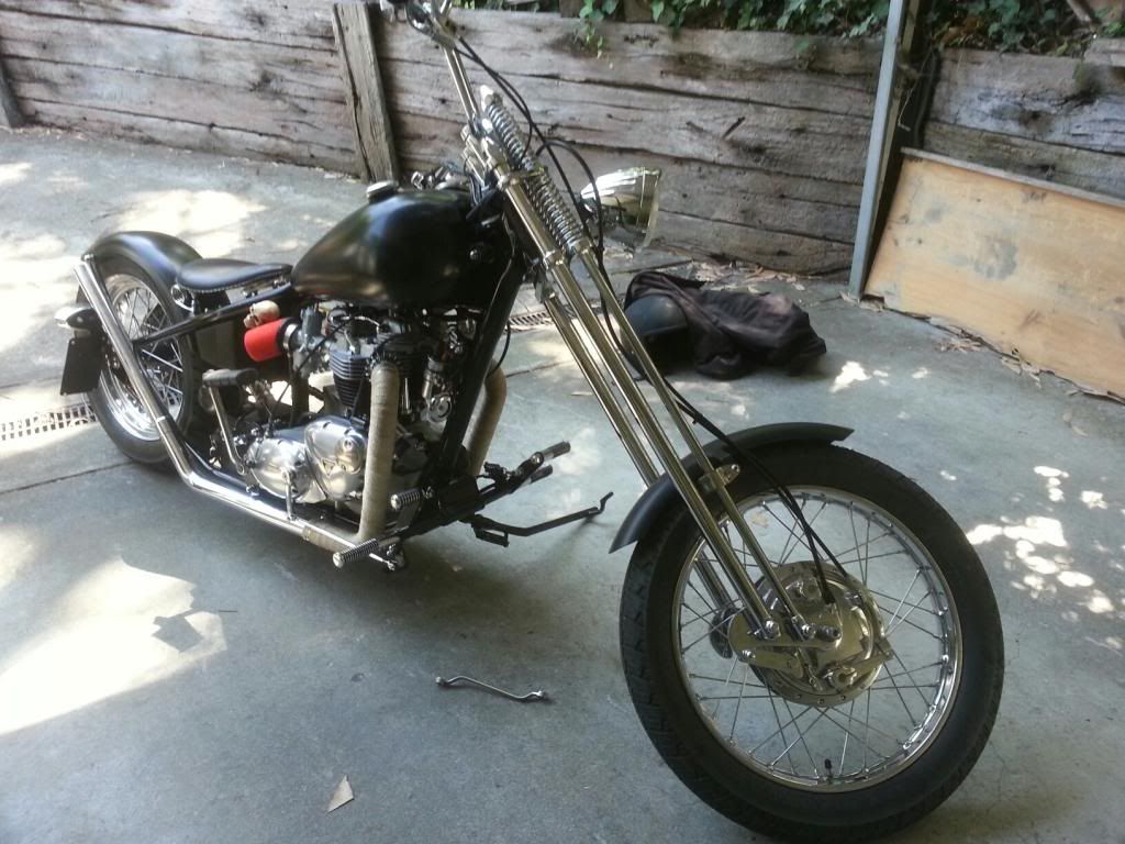

I've decided to use a speedo on it but I'm not sure how to go about getting everything married up to work. What I think I need to know is based on the pics that accompany this string, what kind of front wheel am I running?
A couple of people have commented that it's Japanese but I really don't know. I'm figuring that I need to know what the wheel is and then work from there.

Re speedo, HD front wheel speedos are 2:1 ratio for running on a 90/90/19 front wheel. You can work out your drive ratio by putting a chalk mark on your tyre and a texta mark at speedo drive output. Turn the wheel one full rotation and note how many rotations your drive does. the Kawasaki front wheel hub I have on my shovel is about 2.5:1 so at 80k my stock HD speedo shows around 85k. I live with it. You could use the HD speedo and mark the glass with white paint at the main speeds. Obviously your trip meter will be out to the same degree.
You can also purchase mini speedos to suit jap drives.
HD use two size nuts on the top of the speedo cable; 12mm & 16mm
I adapted a HD speedo cable to the Kawaski drive.
You can take your speedo cable to a couple of places (see fits & Bits forum) to have different ends put on if you find the right ends... Jap bikes of 70's had only a few different fittings at the bottom of the cable. Top fittings are mostly the same.

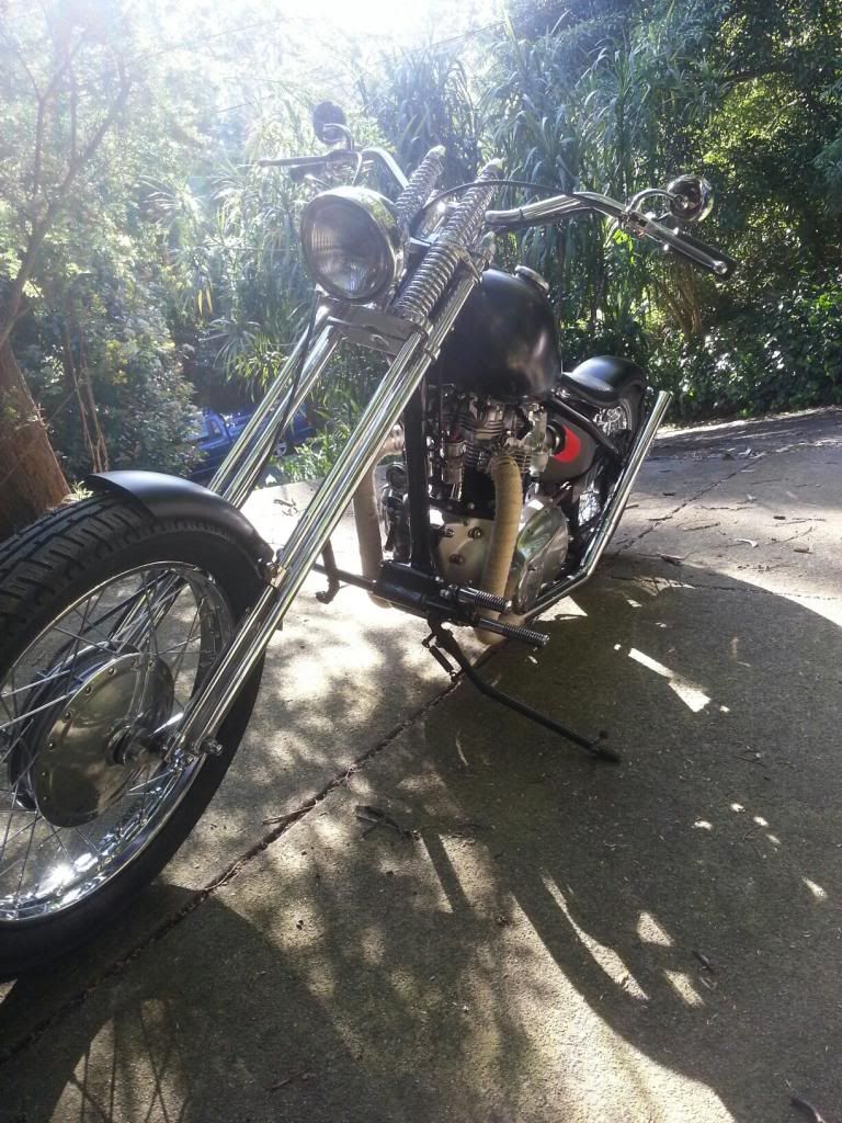

Wicked looking bike. Love the flat black. (and springer) :D
